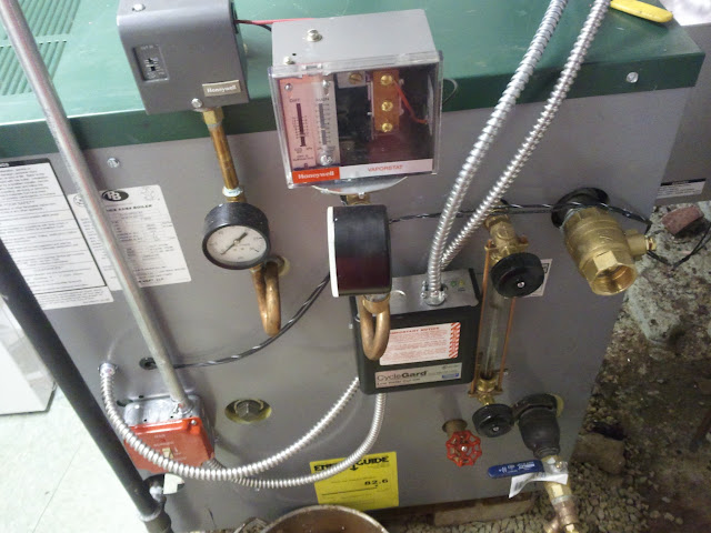

2 different issues ...
@ January 23, 2012 6:34 PM in snubbed by the snubber ...
the vacuum "problem" is not related to the inability for the vaporstat to reset the cut-out. i submit that the snubber may be the culprit here,and I was looking for anyone else with a snubber to chime in.
the vacuum "problem" has been discussed here on the wall several times .. it is due to the contraction of the cooled air between the pigtail and the gauge (presuming the gauge is on the same pigtail). where, as the singular place in the vented system, vacuum is never broken, i was simply looking for a way to break that vacuum.
i have an independent 0-30 manual reset p-trol which is a safety control and NOT an operating control such as the vaporstat.  they are out of different taps on the boiler and are on their own pigtails.

@ January 23, 2012 4:09 PM in snubbed by the snubber ...
I get it now ... thanks for the description ..
I still think that a little Taco 417 valve might do the trick .. but again it may not since there is never really supposed to be water up that high .. or maybe there is at a few oz of pressure .. i've never been inside a pigtail. http://www.taco-hvac.com/uploads/FileLibrary/100-7.1.pdf
I'll get one tomorrow and test it out .. will report back

looked at
@ January 23, 2012 11:54 AM in snubbed by the snubber ...
a 288a todaY. I sucked and blew and couldn't figure out how it worked.
i don't believe snubber defective. i think more likely, vaporstats are the culprit and perhaps they wear out or drift  out of calibration enough to cause a problem at the very low pressures.
exactly...
@ January 23, 2012 11:48 AM in snubbed by the snubber ...
i just realized that insulating the pipes around the gauge area would help since the severe vacuum is caused by the cooling off as well. But i'd love to hash out an automatic way to break that vacuum as well.

@ January 22, 2012 9:20 PM in snubbed by the snubber ...
On 2 different boilers where I have a snubber & vaporstat installed, I am suddenly having problems whereby the vaporstat is not "resetting" after pressure drop ... in actuality, the pressure is not dropping through the cut-in but being held slightly above it .. and thusly leading to a no-heat condition.
Is any other snubber-lubber seeing this problem? I removed the snubber in one of the units and things seem to work much better now.
On a slightly different yet very similiar point, is there any way to allow complete/automatic vaccuum release in the vaporstat tree above the pigtail? I was thinking about a Taco 417 hydro air vent (coin valve) or something. Perhaps a small vaccuum breaker, which I can't seem to really source from anyone...
