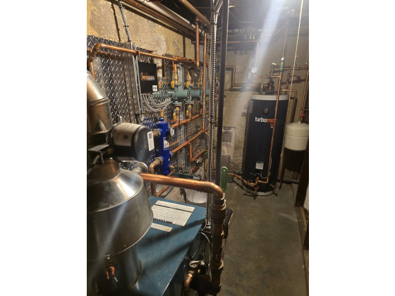

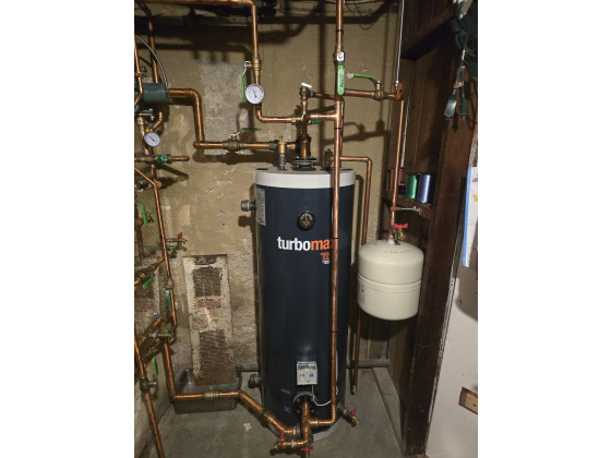

Right off the bat, I saw that this old vapor system had a badly piped header, Hartford Loop, and returns. The HX was piped wrong, and the circulators were in the wrong places. The aquastat was the wrong type AND in the wrong spot. The radiant needed mixing valves, bypasses, and thermometer gauges. All of that was missing. I also pointed out how the flue pipe was not safe and chimney should be checked. Last, I spec'd out all the traps for replacement and recommended a BATTERY of main vents to get the system hotter, faster, and quiet.
We sat down at the kitchen table and I wrote a clear, cogent, and concise report that their trusted, local plumber could follow. I then spent awhile drafting up some isometric drawings of what the piping changes needed to reflect, with great detail.
They brought their trusted plumber back in and he had to call me only once in the beginning to get him flying straight. We spoke once more to walk him through the fine tuning and tweaking. The work was completed by mid February, so they got to see results quickly. The McNultys were thrilled with their “new” quiet, comfortable, and efficient system. They now enjoy warm floors and the electric radiators are stored in the garage. I told them to expect big savings on their gas bill. Last we spoke, their March and April gas bills were much lower than the seasons before. Their plumber is proud of himself and happy he learned something new.
