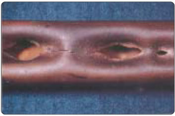

Now pulling a tube bundle from a shell-and-tube heat exchanger involves a lot of nuts and bolts but it was worth it because when we slid it out and looked at the curved end of the tubes we saw the holes. Those tubes looked like someone had taken a hammer and chisel to them.
“There’s your problem,” the contractor shouted. “You make lousy heat exchangers. Look at those holes! And this thing is just a few weeks old. Piece of crap!”
Walter nodded. “Yes, the water from the hot-water system is leaking into the shell of the exchanger. That’s what’s flooding the boiler-feed pump. The transfer pump is just dumping that water into the feed-pump’s receiver. As I said, they teach all this at the Merchant Marine Academy. They call it basic physics. It involves stuff like atmospheric pressure and gravity. You know about gravity?”

“My point is that my finger is the vacuum breaker,” Walter said. “When I lift it, the water leaves the straw. If I don’t lift it, the water stays inside the straw, or inside the shell of the heat exchanger. And when water, which we call condensate, stays inside the shell of a heat exchanger, the steam is going to find it the next time the steam regulator opens. And that steam is going to hammer that water off the back of the steel shell. Then the water is going to bounce back and smash into the tube bundle at the exact point where the tubes are curved and at their weakest. That’s why the tube bundle is leaking and that’s the source of your problem here. And notice I said your problem.”
