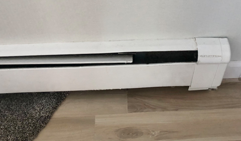

One last adventure for you. This was a quick solve. I looked at a problem job where one room in the middle of a baseboard loop system wouldn't heat. I looked into the cover and noticed that the installer had turned that room's baseboard element 90 degrees before soldering it. The solid side was horizontal and doing a wonderful job of blocking any convective movement of air in that room. The little guys with the bowler hats got off at the other stations.
Can you see it in your mind’s eye?
Good.
