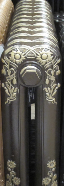

Thad: Sandblast and powder coat for a couple hundred bucks per radiator and they’ll look brand new. The real trick is to bake them for a bit longer so that any outgassing from the cast iron occurs before the powder coat dries. This will avoid any surface blemishes. I have had seven, 100-year-old steam radiators done this way and they all came out fantastic. And a little bonus is that the finish is so smooth that dust and cat hair don't get stuck in between the sections. It just comes out with a whiskbroom, which I use once a month.

Dave: I have radiators sandblasted and powder-coated all the time. They look stunning when they are done. I use a commercial painting company that handles both the blasting and the coating. They have many colors from which to choose. The radiators are cooked at 400-degrees Fahrenheit. It’s important not to get them any hotter than that because the paper gaskets between the radiator sections can be damaged, causing the radiator to leak. Ask me how I know. A large radiator can easily cost as much as $400 for the whole process, plus the time it takes to disconnect, transport to and from the paint shop, and reinstall afterwards. The finish is quite durable, though, and it looks like porcelain.
Patrick: Ditto to everything that's been said about powder-coating. I hate the thought of paying someone else to do what I can do myself with a little sweat and elbow grease, but powder coating is so superior compared to the results I can achieve with even a professional spray setup that I find it's really worth the cost. I've had zero off-gassing issues; the finish is perfect (no drips, drabs, or missed spots), and let's face it – doing a good job of cleaning and painting a radiator of any size is one of the more onerous tasks imaginable. Refinishing radiators seems to me to be a textbook-perfect example of when powder coating makes sense.
