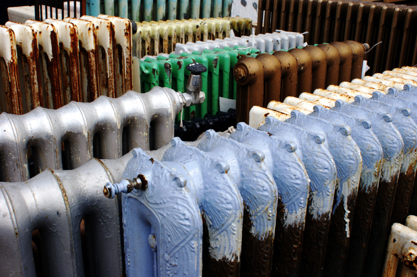

Ever wonder why the Dead Men painted so many of those old, free-standing, steam- and hot-water radiators silver? Yeah, so did I. I did some digging and came up with a delicious story for you. It goes like this.
At the turn of the 20th Century, radiators were mostly plain grey metal. Many of these were fancy, with gorgeous, Victorian-style decorations. Radiator manufacturers did this because central heating was new back then, and they wanted to make the radiators part of the room’s decor. That worked out well and the business grew.

The solution arrived by way of a government report that spoke of the glories of metallic paint, mainly aluminum-bronzing paint. That also had me scratching my head for a while, so I read some more books.
It turns out that with a free-standing, cast-iron radiator about 70% of the heat will come off the radiator by way of convection. The air touches the hot metal and rises. Cold air takes it place and the Ferris wheel-like cycle of heating begins. That’s easy to understand. But the balance of the heat, fully 30% of the radiator’s output, arrives in the form of radiation, which we can’t see. It steams off the radiators and onto the people in the same way that sunlight does.
So I read more books and learned that there are two things that affect radiation: The first is the temperature of the radiator’s surface, and that’s easy to understand. But the second thing is a bit more mysterious. It’s called emissivity, and the emissivity of aluminum happens to be very low. The government tested a bunch of paints that contain aluminum flakes and they learned that if the outermost surface of the radiator is mainly aluminum flakes, the rate of radiation will drop drastically. And we’re not talking convection here. That stays at 70% of the total heat output, but the metallic paint will really chop into that last 30% of the radiator’s heat output.

But back to that metallic paint on the radiators. The overall result of using aluminum-bronzing paint on an old radiator was that the radiator suddenly gave out 20% less Btuh than an unpainted radiator. And again, remember that we’re not talking about convection here; just radiation.
The U.S. Department of Commerce’s National Bureau of Standards published their report on July 19, 1935. You can read it here. The report advises people to use metallic paint on radiators, but only in the rooms that were overheating. They also suggested that folks paint the back of the radiators with metallic paint as a way of lessening the radiant-heat transfer to walls that were probably not insulated.
So that’s why the radiators are the color that they are. If you want to increase the Btuh output of the radiator, all you have to do is paint it again with a non-metallic paint. Sounds crazy, I know, but it’s true. It’s the final coat that makes all the difference.
