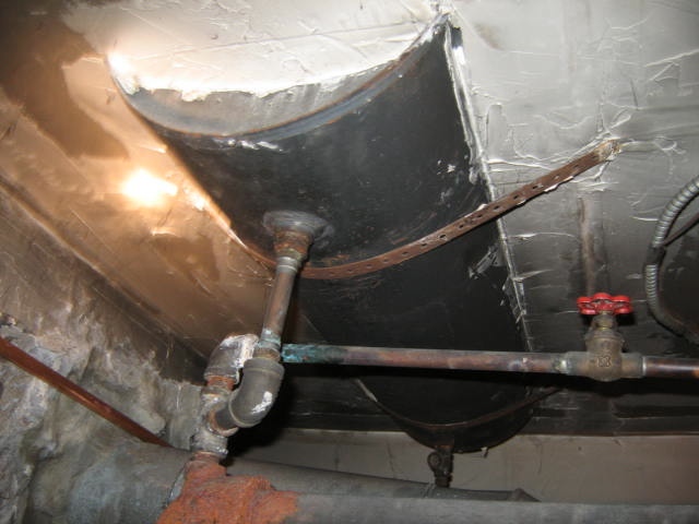

Nitrogen and oxygen are both lighter than water so they want to rise up. That’s why the Dead Men put their expansion tanks at the top of those gravity systems. When they closed the tanks and moved them to the basement to keep them from freezing (around 1915), the expansion tanks became compression tanks. The Dead Men had to put the air in the tank, but it would often leave. It took them a while to figure out why, but they eventually learned that absorption and gravity circulation were the culprits.
When you connect a plain compression tank (that’s one without a diaphragm) to a hydronic system, the water in the tank will absorb the air in the tank because that water is relatively cool. Gravity circulation within the pipe that connects the tank to the system will move the cooler, air-laden water out of the tank. Hot water rises; cold water sinks, and you don’t need two pipes to make this happen. One will do. The rising and falling waters pass each other within that single pipe.
When you vent a radiator the system pressure drops. The feed valve adds cold water, which enters the tank. This problem inspired Amtrol to come up with the diaphragm-type compression tank. They figured that if you could separate the air from the system water there would be fewer problems. Their first tanks had a precharge of 12-psi pressure because that's how much pressure you need to fill a typical two-story house. The used a piece of dry ice to charge each tank. I thought was ingenious. So did they. But as time went by, they learned that the carbon dioxide from the melted dry ice would move through the rubber diaphragm by osmosis and enter the water. There was no way to recharge those early tanks, so Amtrol switched to the Schraeder valve that we see today.
Today's rubber diaphragms still allow the air to move by osmosis, and at the rate of about 1 psi of loss per year. It's the same process that causes air to leave a party balloon. It's always a good idea to check the air pressure in the tank if you're having pressure problems with the system. You have to isolate the tank from the system to do this, though, because the water pressure will squeeze the diaphragm and compress the air, giving you a false reading on your tire gauge.

Suppose you have a system with a lot of water in it. Think about those older buildings with the big pipes and high-volume radiators. You’re going to need a compression tank that’s larger then it would be on a modern system for those jobs. Here's how the Dead Men sized their old-school compression tanks. First they measured the total system equivalent direct radiation (EDR). Once they had that, they did this:
- If there was less than 1,000 square feet of radiation on the job, they'd multiply the total EDR by .03 to determine the tank size in gallons.
- If the total EDR was between 1,000 and 2,000 square feet, they'd use .025 as a multiplier.
- If the total EDR load was greater than 2,000 square feet, they'd use .02 as a multiplier.
More water means more expansion, and that’s why the tank will be so big. If you decide to use a diaphragm-type compression tank on that job, it’s also going to be bigger than it would be if it were on a modern system. Probably a lot bigger, so here’s a rule of thumb for the diaphragm tank on a high-volume system:
Take the size of the standard steel compression tank in gallons and multiply by .55 if the building is two-stories tall or .44 if the building is three-stories tall. The answer will give you the volume of the diaphragm tank.
Here’s an example. Let's say we have a two-story house with 1,000 square feet of radiation. We'll size a standard steel tank first: 1,000 X .03 = 30 gallons. Now, since it's a two-story house, we have to multiply that by .55 to get the volume of the diaphragm tank. (30 X .55 = 16.5 gallons of required volume in the diaphragm tank)
