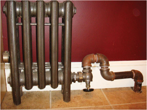

It's one-pipe steam, and the supply valves aren't fully opened. If they're not, you'll get water hammer as steam and condensate try to pass each other within that tight space. The valve on a one-pipe-steam radiator is a service valve. It has to be either fully opened or fully closed. Throttling the valve causes water hammer problems. If you think the valve is fully opened and you're still getting water hammer, check to make sure parts of the valve haven't fallen off and lodged in the valve's seat. If the valve is new, check its internal size. Steam supply valves of the old days had more space inside than their modern replacements. You may have to use a bigger size valve.

Oh, and do you the that steam radiator in the photo was hammering?
