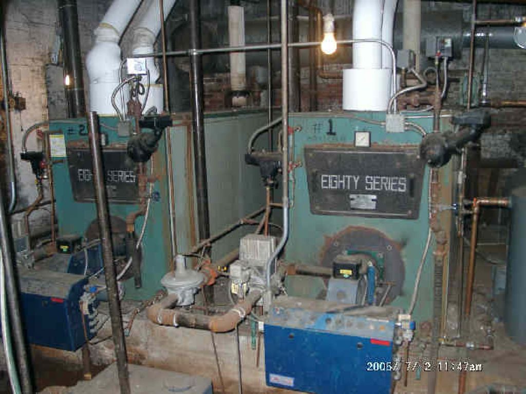

We went back to the basics. We measured the lengths and diameters of all the steam mains, which took long and tortuous paths thru the basement. We then counted up all the radiation in the buildings and discovered that the system could run on just one boiler to heat the building - and even one was a bit oversized. Both boilers had been fired at the same time for years. The building always had two boilers, but one was supposed to be a spare.

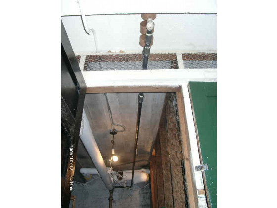

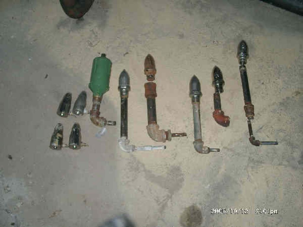

We called in a welder to add thread-o-lets in the proper places, and installed main vents at these points. We used a total of 26 Gorton #2 vents, 1 Gorton #1 and 2 Hoffman #75, in eleven venting stations containing one to five vents per station.

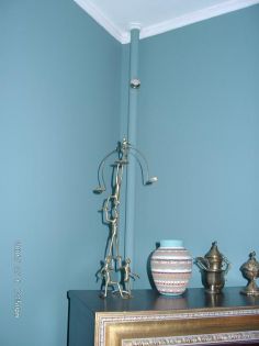

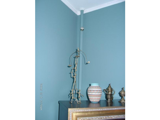

We also vented the steam risers, which extend four stories, with Gorton #C and #D vents.
We set up the boilers so only one could be fired at a time, downfired the burners slightly to more closely match them to the connected load, added low-high-low firing, tuned the burners with a digital combustion analyzer and replaced the old, ailing Honeywell CentraTherm outdoor controller and (misplaced) sensors with a Tekmar #269 and properly placed sensors.
