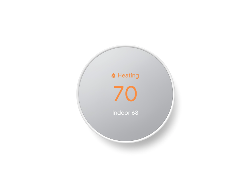

Airzone Control, provider of HVAC solutions for zoning, automation and smart control, today announces a revolutionary new integration with the full portfolio of Nest™ thermostats. The integration between the Airzone Aidoo Pro and Nest smart thermostats (Nest Thermostat™ and Nest Learning Thermostat™) enables seamless bi-directional communication between the Inverter/VRF and mini split HVAC units that are soaring in popularity.

The Airzone Aidoo Pro is a simple-to-install system add-on that sits between the HVAC system and the Nest smart thermostat and serves as a conduit between the world of HVAC and IoT to preserve Inverter/VRF features, benefits, and functionality while meeting user demand for smart control.
Airzone’s exclusive library of manufacturer-certified HVAC protocols enables full bi-directional communication between the Aidoo Pro, the HVAC solution, and the Nest Thermostat or Nest Learning Thermostat. The Aidoo Pro receives smart thermostat data, interprets it, and then sends the appropriate commands to the Inverter/VRF or mini split unit via system specific, manufacturer-certified protocols. The Inverter/VRF solution continues to function at a variable rate, preserving the superior comfort and efficiency of the system.
Airzone has spent decades cultivating privileged working relationships with the industry’s leading HVAC Inverter/VRF and mini-split manufacturers. The Aidoo Pro has manufacturer-certified HVAC protocols from all leading brands, including Daikin, Fujitsu, Hitachi, LG, Mitsubishi Electric, and Panasonic. Now, with a dedicated integration with Nest, the industry’s most popular smart thermostat solutions can be connected to and properly control Inverter/VRF and mini split HVAC systems using the Aidoo Pro.
