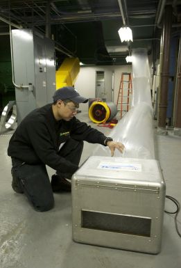

A Unique Approach
Aeroseal technology is applied as an aerosol mist that is pumped throughout the interior of the shaft. Rather than completely coating the walls of the ductwork, the microscopic particles of sealant remain suspended in air until they come in contact with a leak. Here they cling to the edges of the leaks and then to other sealant particles until the entire hole is sealed.
According to Aeroseal LLC, the sole licensee of the aerosol duct sealing technology, Aeroseal is up to 95% effective at sealing leaks in ventilation shafts and air duct systems. Results from its use in commercial building applications have proven that the technology can have an immediate and substantial impact on increasing airflow and reducing energy costs.
