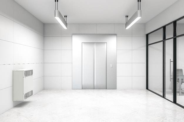

Marley Engineered Products, a leader in high-performance, reliable heating and ventilation equipment for buildings, introduces the CU900 Series Custom Cabinet Unit Heater, which delivers supplemental comfort heat in a contemporary design to match modern and future architect specifications. The unit is operated by the new SmartSeries® Plus, a digital touchscreen control capable of running a fully programmable internal schedule as well as connecting to a BACnet Building Management System.
“The Marley Cabinet Unit Heater offers 16 air inlet/outlet combinations that are all field-changeable for wall or ceiling placement, is easy to install and maintain and features a robust design,” said Kyle Jason, product manager for Marley Engineered Products. “The unit is ideal for a variety of spaces requiring supplemental heat including school hallways, church vestibules, transportation terminals, stairwells, entrances, lobbies, mechanical rooms and more.”
Offered by QMark, the CU900 Series Cabinet Unit Heater features a standard stamped grille with optional ducted grilles and a hinged front panel for one-person maintenance on ceiling applications. A front cover interlock de-energizes the unit when the front cover is removed for added safety. A disposable air filter is mounted in the inlet air stream or choose an optional permanent and washable aluminum filter.
Feature a robust design, the cabinet is constructed of heavy 16-gauge cold-rolled steel to provide strength and finished with a polyester powder coating for corrosion resistance. Motors are mounted with automatic thermal overload protection and motor fuse protection is provided on all heaters to meet safety requirements.
“Each unit comes standard with two thermal safety cutouts to automatically shut off and protect the heater in the event of overheating,” said Jason. “The unit will reactivate when operation temperature returns to normal.”
The Custom Cabinet Unit Heater offers a temperature range of 50 to 100 degrees F. It is available in white, beige, charcoal gray, aluminum, statuary bronze, desert tan or gloss black. Custom colors are available upon request.
