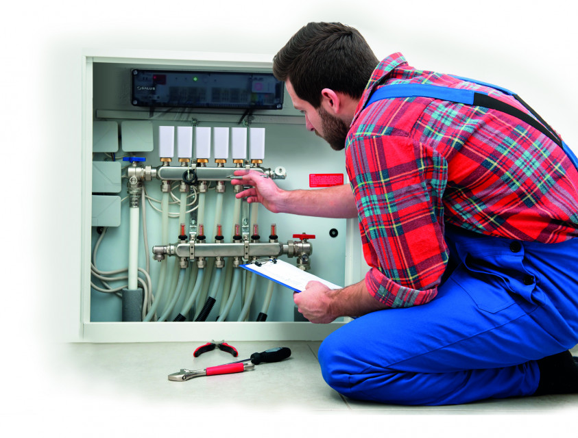

Unlike conventional thermo actuators, the new Auto Balancing Actuator performs the function of both thermal actuator and supply regulator, resulting in two functions in one unit. Complete with two remote sensors that are placed on the supply and return from the manifold, the actuator constantly monitors the temperatures and will adjust the flow rate to maintain a delta of 13oF (7oC) for the UFH circuit. This is the ideal temperature differential between the supply and return; thereby balancing and optimizing system performance.
With a very low power consumption of just 0.5W, the Auto Balancing Actuator uses much less energy than conventional actuators that typically use 2-3W or more. With a speedy opening and closing action of typically 30 seconds, this model is also much faster than conventional thermal actuators that can take three minutes or longer to open or close.
The Auto Balancing Actuator brings several benefits. For the installer, it makes system balancing a simple and quick operation. This is particularly helpful in retrofit installations where the actuator will automatically calculate the supply and return rate even when the pipe length is unknown; thereby saving time and simplifying the installers’ job. Meanwhile, the homeowner benefits from a correctly balanced system that eliminates hot and cold spots ensuring maximum comfort and efficiency, while the UFH supplier will experience less service calls and complaints.
