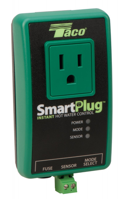

With the patented SmartPlug, using less water just got a lot more efficient. The SmartPlug upgrades a hot water recirculation system to a “Smart” system. SmartPlug technology makes any corded circulator up to 94% more energy efficient by learning hot water usage patterns and delivering hot water only when needed. This increases hot water comfort, reduces energy use and helps to extend the life of the hot water heater.
Installation is quick and easy. There’s no programming or use of timers or aquastats. Simply plug the SmartPlug into a 110V outlet, then plug the circulator power cord into the SmartPlug.
Using a sensor that mounts to the hot water supply pipe, the SmartPlug will learn the daily hot water usage pattern in a home or business and adjust the circulator run time automatically to delivery hot water only when needed. When usage patterns change, the SmartPlug adjusts run time automatically.
The SmartPlug also includes a “pulse” mode option that continuously cycles the circulator on for 5 minutes, then off for 10 minutes, as well as a “vacation” mode that shuts the circulator off after 36 hours of no hot water use. While in vacation mode, the SmartPlug’s exercise function cycles the pump for 10 seconds every seven days to prevent corrosion or scale build up.

SmartPlug can be applied for light commercial use because it’s rated for connection to domestic hot water recirculation pumps at up to ½-HP in size, or 6 amps. But its key application will be in the residential retrofit market.
Today, more and more homes and businesses have hot water recirculation, yet many of those systems have no intelligence to improve operation (convenience + comfort) or to conserve water or energy. This product – just by plugging it in and connecting an existing hot water recirculation pump into it – quickly avails all of that.
One of the best pieces of news for installing contractors is that such an important upgrade can happen so quickly. Literally, the product is plugged into the wall, and an existing “dumb” hot water recirc pump is plugged into the SmartPlug. Then, a sensor is also connected to detect temperatures in the recirc loop. That’s it.
