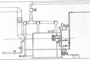

Years ago, steam heating was a business of installing complete systems and not just a business of replacing boilers and fixing problems, as it is today. Manufacturers mad...

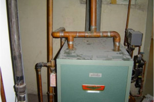

A question asked on The Wall: "What's the point of building a drop header for a steam boiler, and what does it look like?" Steamhead replies: The drop header keeps water ...

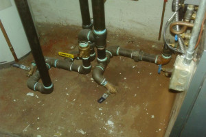

Always ask, "What can cause this?" I once looked at a house in New Jersey where the first-floor ceiling had caved in due to a disagreement with the steam system. This was...

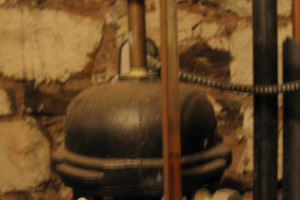

A question asked on The Wall: "Is it okay to use copper on steam systems?" Brad White replies: It is not so much temperature as cyclical heating and cooling. Hot water ru...
