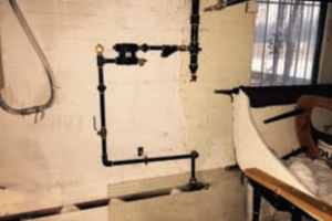

We service the steam system in an old apartment building in the Dupont Circle neighborhood of Washington, D.C. The Avondale Apartment Building was built in 1914, and has ...

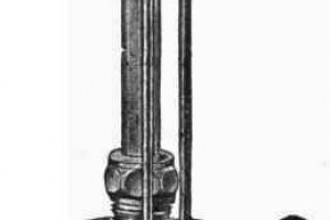

If the water isn’t right, the steam won’t be dry. Dry steam is a technical term. It means that the steam leaving the boiler contains no more than two percent liquid water...

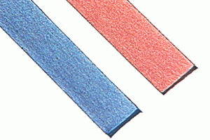

What’s the cheapest tool you can carry if your business includes taming old steam-heating systems and making them purr with greater efficiency? Litmus paper! You probably...
