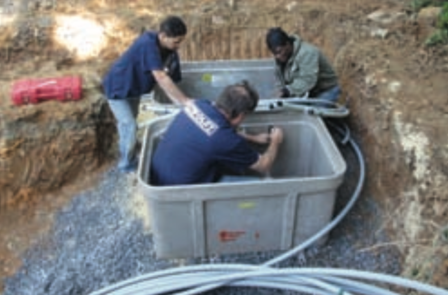

I like to tie all my loops to a manifold located in a buried vault, as indicated in the photos below. This allows for isolation and purging of individual loops and for balancing, if required. I then run a pair of large dimension PEX mains back into the mechanical room.
We like to use heavy-duty concrete utility vaults to house the manifolds. They are more expensive than the plastic irrigation boxes, but I have found them to withstand jobsite abuse better than the plastic boxes. We use these same vaults for snowmelt manifolds, as well.
