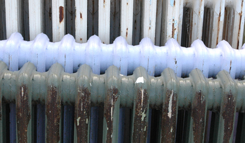

“I need a new radiator,” the homeowner said. He handed Tony a photo. “This is what the old one looked like. It broke.”
Uncle Tony took the photo and looked at it. It was a sectional, cast-iron radiator.
“That’s an old one,” he said.
“I guess it came with the house,” the homeowner said.
“How did it break?"
“It just didn’t work as it should.”
Uncle Tony took a closer look at the photo. “You have a one-pipe steam system, right?”
“I have oil,” the homeowner said.
“I don’t mean the fuel. I mean the type of heating system. This is one-pipe steam.” He pointed to the photo. “See this? That’s a steam air vent. And over here. There’s just one pipe connecting the radiator. That’s one-pipe steam.”
