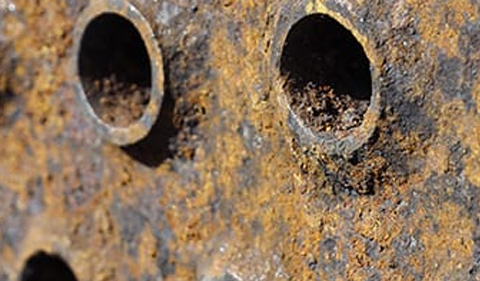

Clogging up heating surfaces is sort of like having all the traffic lights in your town turn red at the same time, and then stay red. Most movement just stops. In the case of boiler sludge and scale, that movement is heat. It's trying to get from the fire, through the metal, and then onto the conveyor belt of flowing water but sludge and scale can block the way. So the boiler just keeps getting hotter as the building gets colder, and that's not good for either one.
Simply put, pipe sludge is nothing more than rust that flakes off the inside of the pipes. It will just go with the flow into the places that will cause you the most grief. Get enough of that sloppy stuff flowing around and it will gum up the whole works.
Mineral scale is different. In a boiler, it's mainly stubborn calcium carbonate, which never wants to dissolve in hot water. Behind this scaly pest, other minerals will line up, hold hands, and insulate the fire from the water. That hand-holding happens in this order of appearance: calcium sulfate, magnesium carbonate, iron, silica and manganese. And you can add to that menu, phosphates and hydroxides of any of those minerals that just want to ruin your day. It pays to know the enemy, and the only real way to do that is to get the water analyzed if you suspect there's a problem.
It also pays to understand the simple magic that creates scale. Think of a hot cup of coffee. You add a spoonful of sugar and give it a stir. The sugar instantly dissolves, and the hotter the coffee is, the quicker that will happen. That also happens with salt, but if you’re putting salt in your coffee you probably have problems worse than boiler scale. The important thing to know is that sugar and salt will dissolve in hot liquids.
The minerals that cause scale in a heating system do just the opposite. They are inversely soluble. That means that the hotter the water gets, the less those minerals will want to dissolve into the water. And since the inside of a boiler is pretty hot, scale is very happy to call it home.
And where do those minerals come from? They’re in the cold feed water, which comes from rain that rolls downhill all over the planet. And since the planet is made largely of minerals, the minerals look at the flowing water as its means of getting from here to there. Keep in mind not many contractors will fill their heating systems with pure water and most contractors are not adding chemicals that get rid of the minerals. They just open the feed valve and let ‘er rip. So the burner runs and the minerals come out of solution as the water gets hot. They cling to the hot surfaces on the inside of the boiler and do a fine job of insulating. That's when the traffic lights start turning red.
