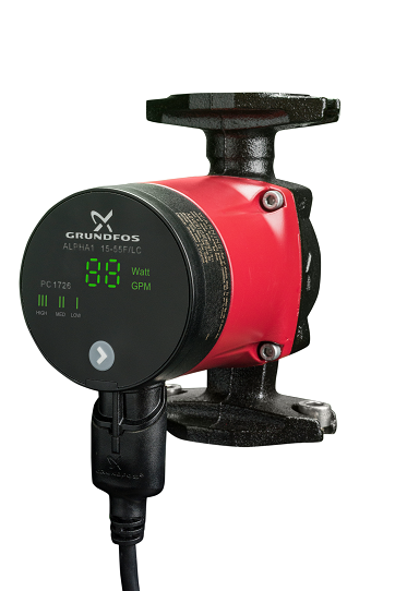

Versatile Operation: The three constant pressure control modes of the ALPHA1 are simple to use with a single push-button control that allows hassle-free operation for installers who can switch between pressure modes depending on the application. ALPHA1 is available in both cast iron and stainless steel models, as well as standard and rotated flange pump housing configurations. Furthermore, ALPHA1 is also available in either line-cord or terminal box electrical connections.
Reliable, Tested Technology: At the core of ALPHA1 is an ECM motor featuring a magnetized rotor to avoid motor-slippage problems common to induction-type motors. The result is a dramatically more efficient motor that generates less heat and energy waste, while delivering a starting torque four times higher than a standard induction motor, and stronger than any other ECM pump in its class—a key feature should the circulator experience long periods of idleness. In the case of a blocked rotor, the ALPHA1’s constant restart feature attempts to restart indefinitely every seven seconds.
Compact design = easy installation: The sophisticated electronics of the ALPHA1 are fully integrated within the motor, which simplifies installation in tight spaces. The easy-to-read LED real-time display shows a flow indicator in gallons per minute and energy consumption in Watts.
ALPHA1 offers a flow range of 0 to 19 GPM (0 to 72 Liters per minute) and a head range from 0 to 19 feet (0 to 5.8 meters). It can handle fluid temperatures from 36°F to 230°F (2.2°C to 110°C) with a maximum working pressure of 150 pounds per square inch (psi).
