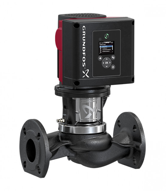

Designed to significantly advance pumping systems for commercial buildings, Grundfos has introduced a state-of-the-art TPE3 in-line pump that features best-in-class technologies that deliver greater efficiency for heating and cooling applications. The newest addition to Grundfos’ portfolio of intelligent pumping solutions, the TPE3 showcases a Permanent Magnet Motor, leading-edge hydraulic efficiencies, a series of advanced control modes, multi-pump functionality, and easy install, monitoring and commissioning that boost system efficiency and deliver overall greater heating and cooling performance.
