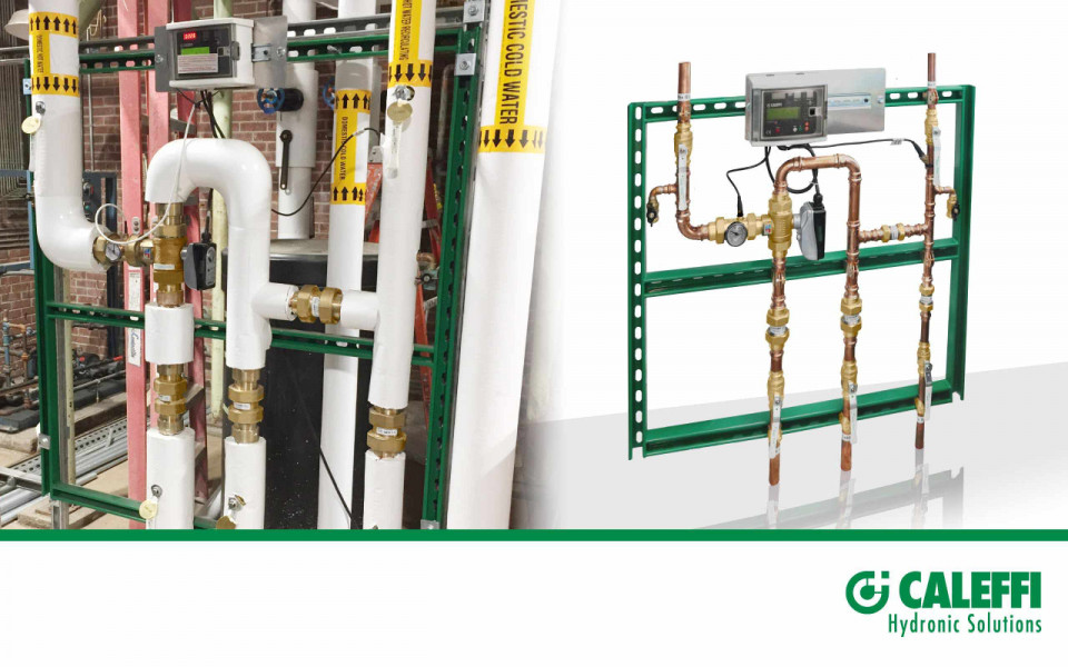

The Stations are pre-built for ease of installation and include a 6000 Series digital mixing valve with union connections, serviceable stainless steel check valves, purge test ports, isolation valves and a LEGIOMIX controller, all pre-mounted on a powder-coated painted steel strut frame. The controller is pre-wired to a 115/24 VAC plug-in transformer. The Stations are available in five sizes from 1” to 2½” copper pipe connections.
"Installing and piping a commercial digital mixing valve properly takes a lot of planning and thought and, unfortunately, mistakes are common. The LEGIOMIX Stations simplify all that because the pipe connections are all pre-labeled and all the components are in the right place. Just hang it on the wall, connect the inlets and outlets and plug in the controller," said Kevin Freidt, director of product management and technical support.
