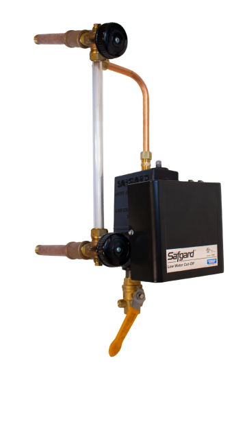

The Steam Pro Kit combines an advanced electronic low water cut-off with rugged components and installer-friendly features to deliver reliable protection, streamlined installations, and straightforward retrofits. The Steam Pro Kit features an electronic low water cut-off with a single probe design that provides reliable operation, reducing maintenance requirements and minimizing nuisance service calls for contractors and building owners. As a replacement for popular mechanical steam low water cut-offs, the Steam Pro Kit serves as a direct upgrade path for existing installations, making it easy for contractors to specify and install in place of legacy controls. Quick hook-up fittings speed up the installation process, helping installers reduce labor time and costs.
To support broad field use, the Steam Pro Kit adapts to all 8" to 14" sight glasses, delivering universal compatibility that eliminates the need to stock multiple models and simplifies inventory management. It uses Hydrolevel’s patented cast iron hub assembly for durable, long-lasting performance and overall system integrity in demanding steam environments, while an included wiring whip streamlines setup with simple, clear wiring that reduces installation time and minimizes errors. The Steam Pro Kit also incorporates indicator LEDs for visual status confirmation, enabling technicians to quickly troubleshoot and monitor operation without additional tools. Flush to test technology allows easy system verification so installers can confirm proper operation on site before leaving the job.
