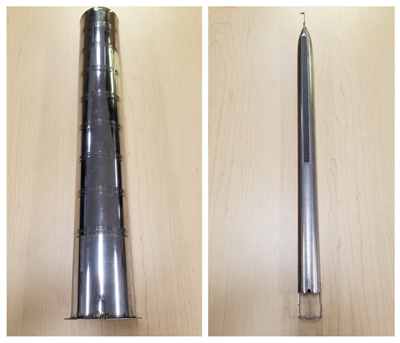

Steam boilers traditionally use an inexpensive lance port burner, which (with a downdraft) can, in some cases, “flash back.” This is combustion within the burner tube itself. When gas ignites at the burner inlet (sometimes called helmholtzing), it makes objectionable noise and can lead to burner damage. To avoid this issue altogether, The SteamMax features a very high-tech stainless steel burner. Instead of a lance port burner, the new burner looks similar to what you’d find on a high efficiency condensing boiler.
