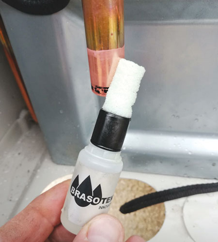

Marketair Inc., an Edison, N.J.-based supplier of specialized and innovative installation components for the North American HVAC market, introduces Brasotek, a cutting-edge, time-saving method for prepping copper pipe and fittings prior to brazing.
Brasotek replaces traditional methods and reduces the time needed to clean the joint areas on brazed copper linesets by more than 50 percent. It conserves filler rod, reduces the need for flux, requires lower brazing temperatures and less brazing time by 15 percent. The eco-friendly, non-toxic and biodegradable liquid, which is non- flammable, is intended primarily for linesets as used in most ducted or ductless VRF/VRV AC systems, but can also be applied to most plumbing, hydronic heating or any installations requiring copper pipe and fitting brazing.
Brasotek is available in two configurations: The BTA-5 Mini is a small felt-tipped, pen sized applicator with a 6-ounce (5-ml) bottle for smaller pipes, and the BTA-20 MIDI is a larger version with 6.7-ounce (20-ml) bottle and 1-inch-long applicator pad for larger pipes. Both versions eliminate the cleaning of joint areas with emery cloth, which is difficult to use correctly on interior surfaces, very time-consuming, susceptible to deep scratching surfaces and creates copper dust and filing residue, which often migrate into the interior of the lineset and create a potential to clog valve orifices.
Currently the only known liquid brazing preparation of its type for copper pipes and fittings, the patented Brasotek solution is simply brushed on to the surfaces surrounding the weld area and evaporates within 5 to 10 seconds. This provides a bright clean surface that remains usable for up to 90 minutes. The result is perfectly brazed connection when using a silver/phosphorus filler rod commonly-used in high pressure refrigerant applications.
