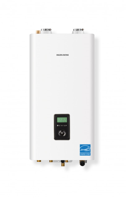

Navien, the leader in high-efficiency condensing technology, has introduced the new NFC series stainless steel fire tube combi-boilers at AHR 2019 in Atlanta, GA. This innovative product will be available in two sizes, NFC-175 (175,000 BTU/H) and NFC-200 (199,900 BTU/H), with enough heating input for up to a 3,500 square-foot home and continuous domestic hot water supply for up to three bathrooms. Best applications include retrofits and new installations in single-family homes, multi-family houses, and light commercial buildings.
The new Navien NFC combi-boiler models come with a patented in-house designed and manufactured heat exchanger, Low Profile Burner for ease of service, advanced controls offering intuitive user navigation, a built-in DHW module (pump, flat plate heat exchanger, 3-way valve, mixing valve, water adjustment valve and auto water fill valve), common venting capability up to 8 units, cascading capability up to 16 units, and built-in hardware to connect up to 3 zone pumps without a need for additional external controllers.
