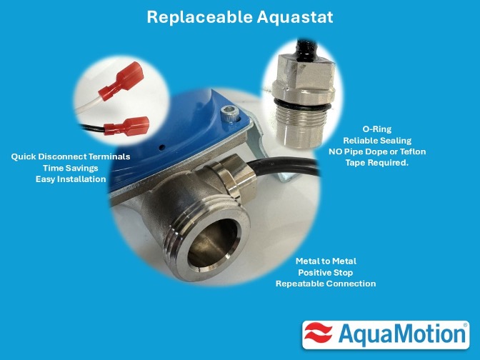

AquaMotion now features a replaceable Aquastat. The new design incorporates an O-ring seal and quick disconnects for the wiring in the control box. Now we have a sustainable, repairable product without waste.
The homeowner or installer can replace it in 5 minutes. With this improvement, the customer saves hundreds of dollars and gets the benefit of instant hot water and saving 12,000 gallons of water annually.
