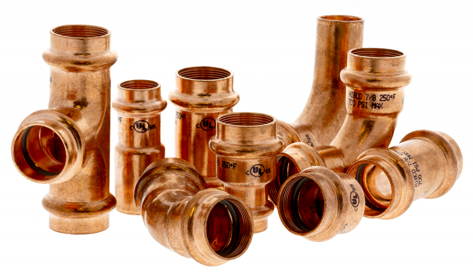

NIBCO PressACR fittings are UL recognized to 700 PSI and feature a gray HNBR (Hydrogenated Nitrile Butadiene Rubber) seal to help differentiate them from other NIBCO press products. Straight and reducing couplings, 45 and 90 degree elbows, caps, Y-joints, and tees are available in sizes ¼”, ½”, 3/8”, 5/16”, 5/8”, 7/8”, and 1-1/8”.
Made in Stuarts Draft, Va., with the highest quality of globally sourced pure copper, PressACR fittings feature our patent pending groove design and are specifically engineered to install with the NIBCO PressACR 19kn tool which creates a round crimp pattern that supports the higher pressure requirements of HVACR systems.
