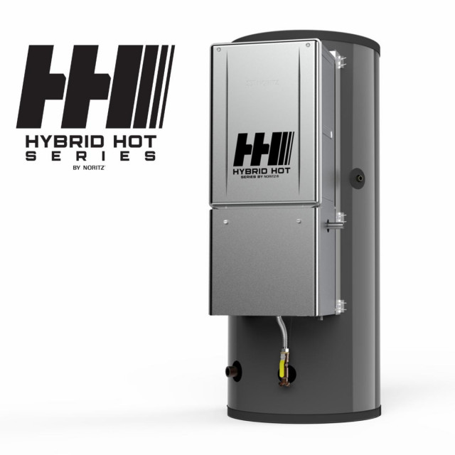

Leading tankless water heater manufacturer Noritz America has merged the benefits of storage in a standard tank water heater with the efficiency of tankless into one powerful unit, the Hybrid Hot Series. Making its debut at the 2023 AHR Expo, this new hybrid unit provides a continuous hot water supply and quick hot-water recovery with an industry-leading 10-year warranty.
The Hybrid Hot mounts the Noritz NCC199CDV commercial condensing tankless water heater onto a 119-gallon storage tank. The tankless unit draws cold water from the side port of the attached tank.
Once heated within the NCC199CDV to the desired temperature, set between 100°F to 185°F, the heated water travels via a pipe that connects the hot-water outlet at the bottom of the tankless water heater to a port located on the side of the storage tank near the top.
The combination of the storage tank and tankless water heater in the Hybrid Hot Series offers flexibility for indoor commercial applications, such as restaurants and hotels, that require a large dump load of hot water over a short period of time without the use of multiple tankless water heaters. The hybrid unit has a 317 GPH (gallons per hour) delivery rate and is equivalent to two tankless water heaters.
