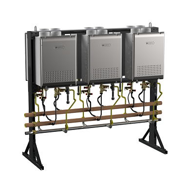

The new Commercial Water Heater System from Noritz America is designed to speed and simplify the installation of multiple tankless water heaters for plumbing and mechanical contractors. Noritz combines commercial-grade tankless units with system controllers, manifolds and other necessary components and accessories into fully assembled metal rack systems for shipment anywhere in North America. The prefabricated system significantly reduces the burden on the installer, who needs only to connect the water and gas lines, build the vent runs and set up the pre-wired system controller.
“Our goal is to reduce installation time and expense while maximizing safety, performance and reliability when building multi-unit tankless systems from scratch — either in the shop or on the job site,” says James Facer, National Accounts Manager - Commercial at Noritz. “With our new prefabricated system, which integrates the only commercial-grade tankless water heaters on the market, we want to bring installation as close to ‘plug-and-play’ as possible for the contractor.”
Thirty-six different rack models are available, all specifically designed for the commercial Energy Star®-certified NCC199(GQ-C3257WZ US) Condensing Tankless Water Heater Series. With a thermal efficiency of 94% DV (95% OD), this model offers inputs from 16,000 Btu/hour to 199,900 Btu/h and a maximum flow rate up to 11.1 gallons per minute.
