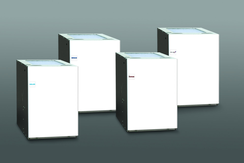

Nortek Global HVAC, the industry leader in manufactured and modular housing HVAC systems, introduces the model E7, the next generation of its legendary E-Series electric furnaces for the Intertherm®, Miller®, Revolv® and Broan® brands. The E7 is the HVAC industry’s first 16-speed model that’s compliant with both the Department of Energy’s (DOE) new fan energy rating (FER) and HUD standards for manufactured and modular housing.
The E7 features a 1/2-hp. electronically-commutated motor (ECM) fan and a control board that facilitates the 16 speeds. The multiple speeds give HVAC contractors more flexibility for pinpointing homeowners’ air comfort, versus the previous E6 and E5 generations’ permanent split capacitor (PSC) fan motors and four speeds.
The control board’s seven-segment-style readout screen expedites troubleshooting by displaying operational modes of cooling, heating, fan circulation, dehumidification, motor fault, lockout and idle.
The E7 offers unprecedented heat control using DC relays, which operate reliably, quietly and significantly reduce service troubleshooting time, versus older contactor and sequencer technologies.
The new generation is available in a 29-inch high (736-mm) E7EM heat-only base unit, or 60-inch-high (1,524-mm) E7EU upflow and E7ED downflow models, the latter two come with a coil box for field-installing the optional evaporator coil and accompanying filter. All three models offer 10, 12, 15, 17, 20 or 23-kW heating elements. All E7 models have a 20 (w) x 24 (d)-inch (508 x 609-mm) footprint that’s identical to earlier E generation models, making them easy drop-in replacement candidates.
Other serviceability features includes a single two-pole DC relay, which expedites circuit testing versus two single-pole relays. Also, instead of just conventional black and red circuit wiring, each circuit is now identified by its respective black, red, yellow or purple wiring for fast traceability and diagnostics.
Aesthetically, the E7 comes with a baked enamel white finish and an appliance-quality access door.
