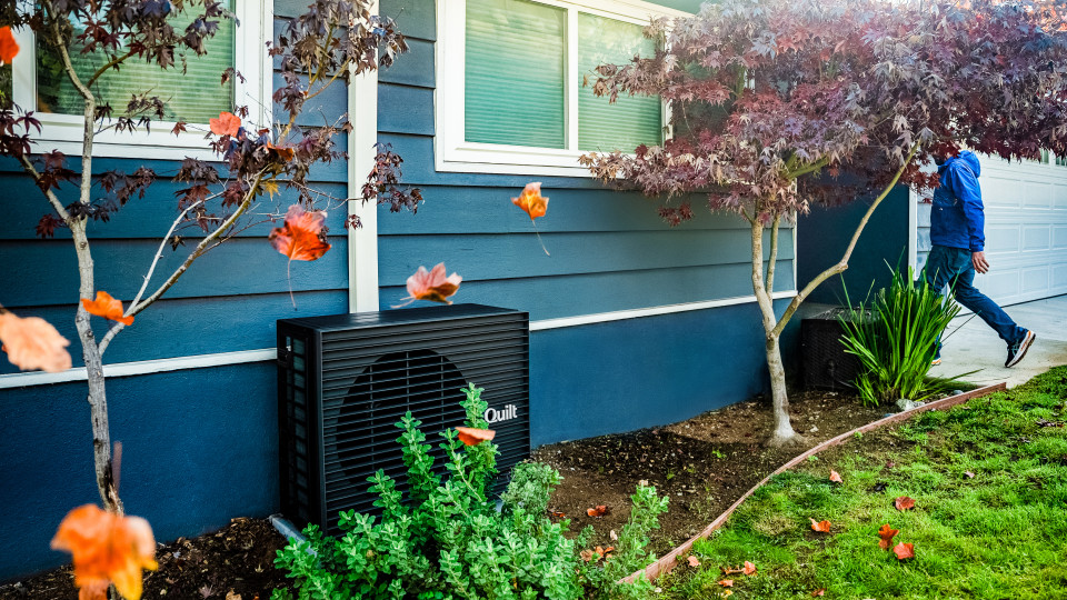

The 3-zone outdoor unit sets new efficiency standards with ratings that exceed Energy Star Most Efficient and Cold Climate criteria. The system maintains 100% heating capacity down to -5°F and 88% capacity at -13°F, addressing one of the most persistent concerns about heat pump performance in colder regions.
At 52 dBA, the unit operates quieter than a normal conversation — critical for meeting strict urban noise ordinances — while maintaining the matte black architectural design that has become a Quilt signature. The compact footprint (36 9/16" x 14 9/16" x 30 7/16") reduces outdoor space requirements compared to multiple 2-zone units.

The 3-zone outdoor unit changes the economics of larger ductless installations. Installers can now handle three-room projects with one outdoor unit, or five- and six-room installations with just two outdoor units — delivering competitive pricing while maintaining Quilt's premium margins and reducing the outdoor footprint homeowners must accommodate.
Pre-charged with 2,400g of R-32 refrigerant — good for all lineset lengths with no additional charging required — the system simplifies installation while using a refrigerant with one-third the global warming potential of conventional R-410A. Quilt's dedicated technical support line, staffed by in-house expert technicians, provides installers with direct access to product specialists throughout installation and service.
