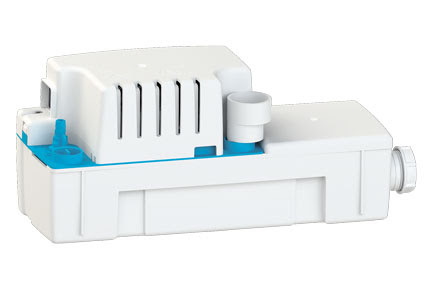

Saniflo U.S.A.® has introduced a sleek, lower-profile version of its Sanicondens Best condensate pump, with nearly double the tank volume and capable of serving multiple mechanical systems, up to a total of 500,000 Btu per hour.
Like its two-in-one predecessor, the new Sanicondens Best Flat combines a condensate pump with pH-neutralizing pellet tray into a single, space-saving, environmentally friendly solution for today’s ultra-high-efficiency condensing equipment, both residential and commercial: boilers, water heaters, air-conditioning and refrigeration systems, and other appliances.
The Sanicondens Best Flat boosts the pH of the acidic condensate before it can be discharged into a drain line — thus preventing corrosion. The condensate is neutralized as it comes into contact with the neutralizer pellets in the tray before being pumped safely away through a 3/8-inch discharge line into the sanitary sewer or a septic tank.
