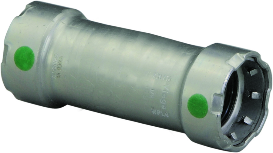

Viega introduces six new, extended no-stop coupling options for the Viega MegaPress and MegaPressG systems for joining schedule 5 to schedule 40 black iron pipe in sizes 1/2" to 2".
The Viega MegaPress system uses modern cold press connections for pipe installation. The Viega MegaPress system is ideal for hydronic heat, chilled water, compressed air, fire sprinkler systems, low-pressure steam and vacuum lines. Viega MegaPressG fittings are designed for use in fuel oil and natural gas applications.
The MegaPress and MegaPressG extended no-stop couplings are available in the following sizes: 1/2", 3/4", 1", 1 1/4", 1 1/2" and 2" sizes.
